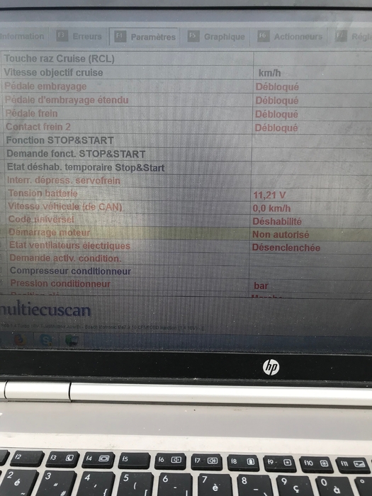

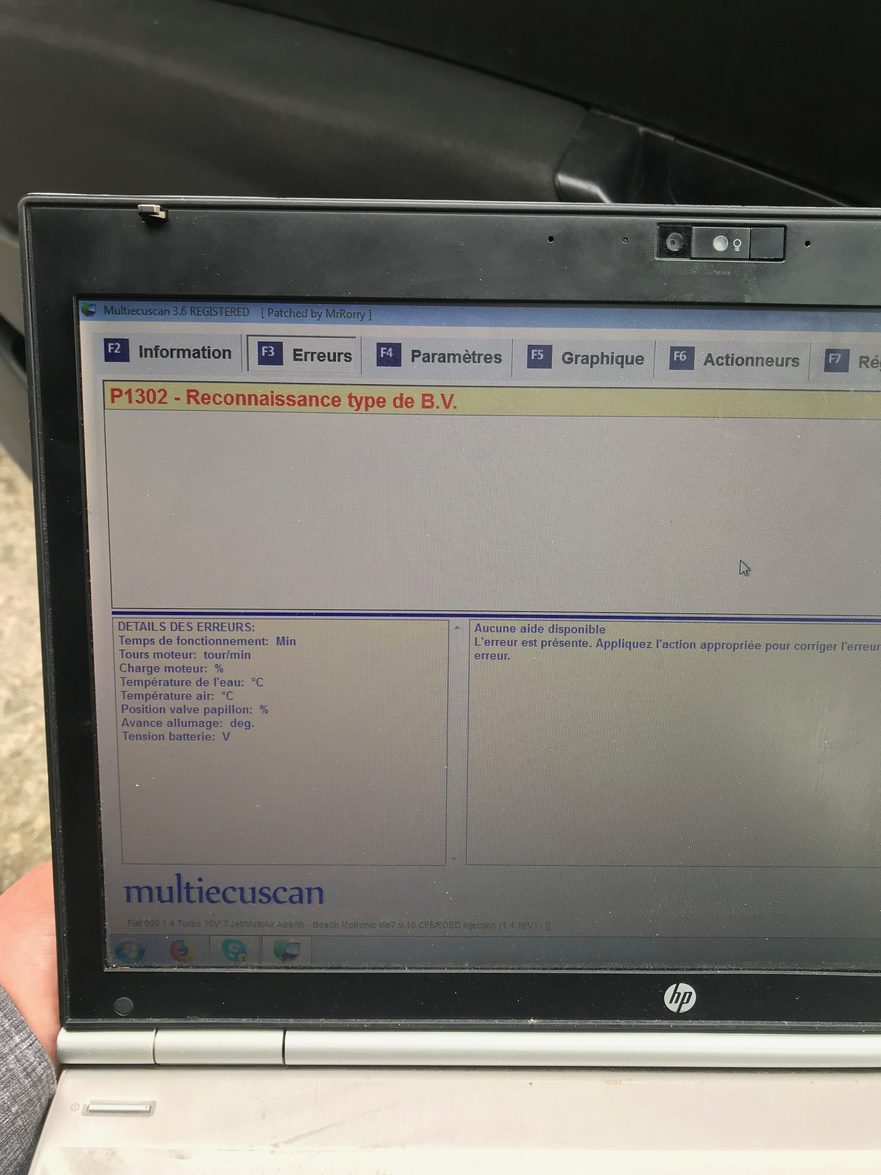

Voici les seuls dtc present
---------- Post added at 15h40 ---------- Previous post was at 15h37 ----------
---------- Post added at 15h41 ---------- Previous post was at 15h40 ----------
DESOLER POUR LA TAILLE DES CAPTURES
