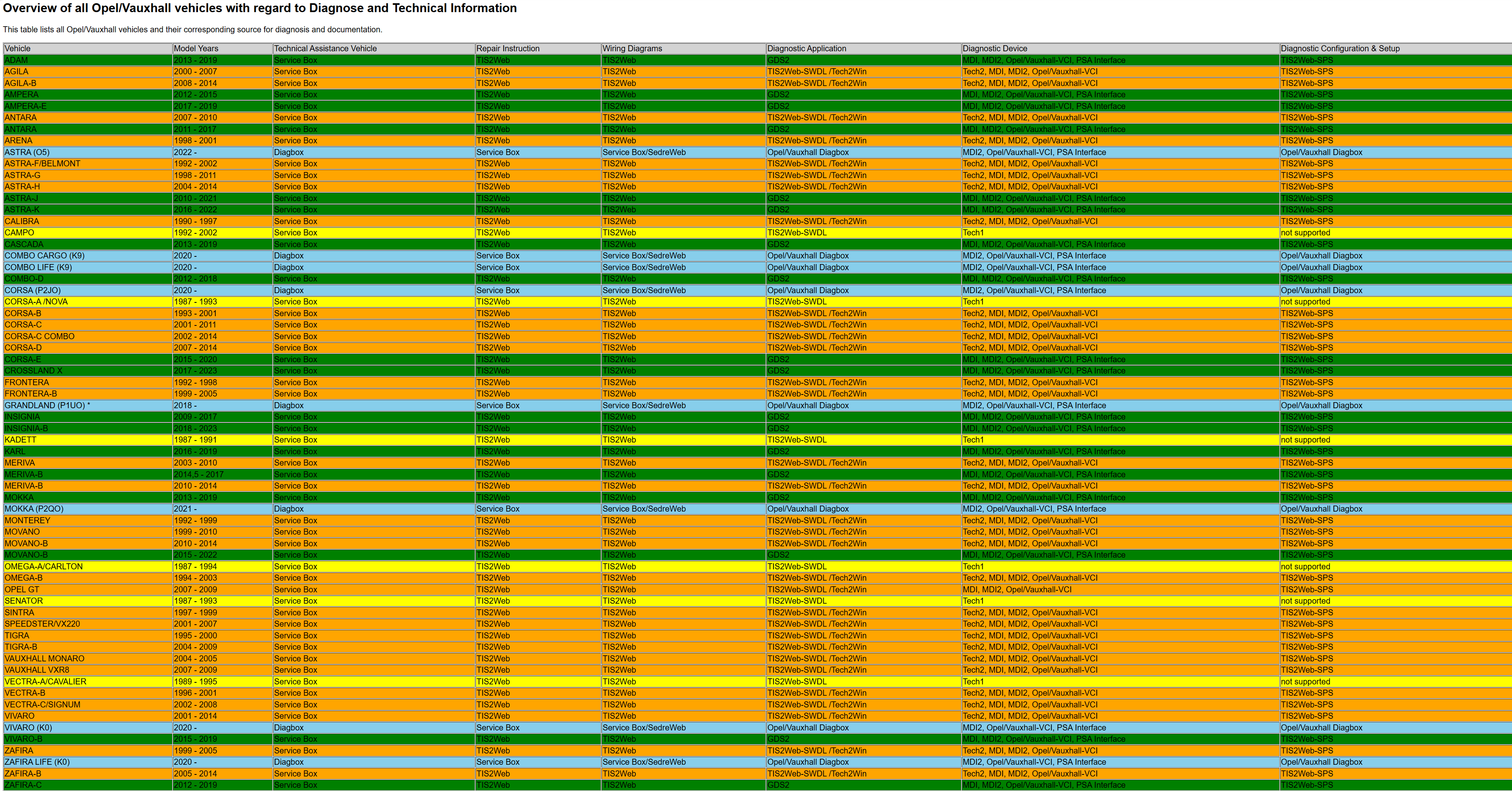

Works with Diagbox(native-passthru)
Works with GDS2 (pics in atth)
Works with pcmflash :) (just did read ident) usb and wifi
Works with Diag...ser as PassThru

Intéressant ton tableau merci :-)
Tu as d autres documents ou informations ?
C'est le Diagalyser dont tu parles ?
